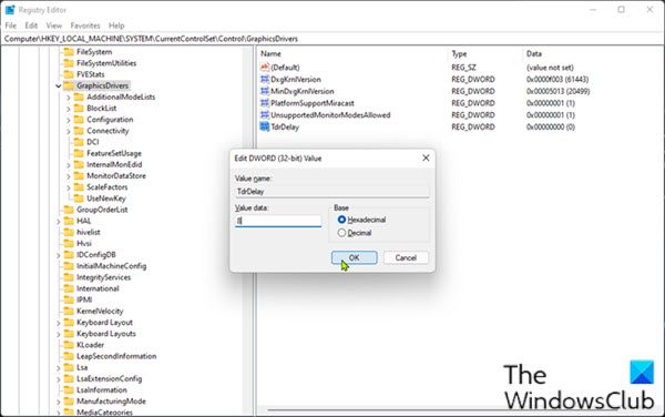

13] Modify Registry
This error can occur If due to a glitch, the graphics card driver is taking too long to respond to the Windows OS, thereby resulting in the timeout issue. In this case, increasing the wait time (TDR Delay) of Windows may solve the problem.
Do the following:
Computer\HKEY_LOCAL_MACHINE\SYSTEM\CurrentControlSet\Control\GraphicsDrivers
- At the location, right-click on the blank space on the right pane and then select New > DWORD (32-bit) Value to create the registry key and then rename the key as TdrDelay and hit Enter.
- Double-click on the new entry to edit its properties.
- Input 8 or 30 in the Value data field.
- Click OK or hit Enter to save the change.
- Again, right-click on the blank space on the right pane and then select New > QWORD (64-bit) Value to create the registry key and then rename the key as TdrDelay and hit Enter.
- Reboot PC.
On boot, check if the issue is resolved. If not, do the following:
