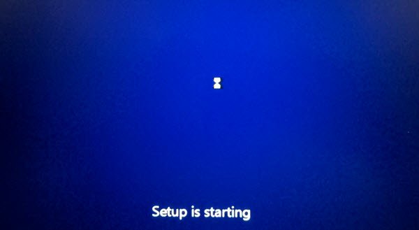

The setup will start.

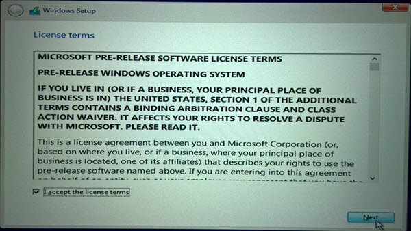

You will be presented with the License terms. Accept it and click on Next.

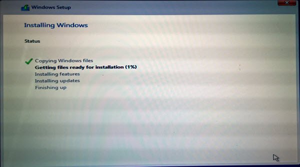

Windows 11/10 installation will start. It will copy setup files, install features, install updates, if any, and finally clean up the residual installation files. Once this is done, your PC will restart.

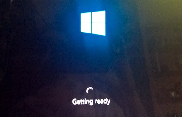

On the restart, you will see the following screen.

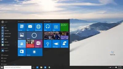

Windows 11/10 will ask you a few basic questions about your preferences before completing the installation and taking you to the Windows 11/10 desktop.
