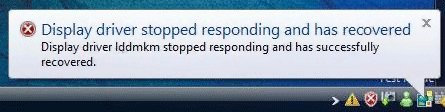

One of the most common GPU-related errors and crashes are referred to as Timeout Detection and Recovery or TDR errors in logs, Event Viewers, etc. The most common error message you might find when this happens is “Display driver stopped responding and has recovered” and a BSOD with the stop code Bug Check 0x116: VIDEO_TDR_ERROR.In this article, I’ll suggest you few methods to troubleshoot such errors.
TDR is present in Windows 11, Windows 10, Windows 8.1, Windows 7 and Windows Vista. TDR attempts to detect problematic situations and recover to a functional desktop dynamically.
The most common error message you might find is “Display driver stopped responding and has recovered” – also you might also get BSOD with the stop code Bug Check 0x116: VIDEO_TDR_ERROR.

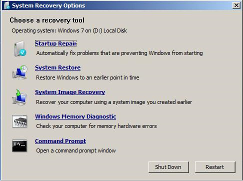

- Check your Memory i.e. RAM. If your RAM is failing on you, it’s quite possible that this is what is causing your Display to crash. Check our article on how to run Memory Diagnostic Advanced Memory Diagnostic with Memtest86+. Also, check if the timing and voltage of the RAM are set correctly in your BIOS refer to your Motherboard and RAM manual.
