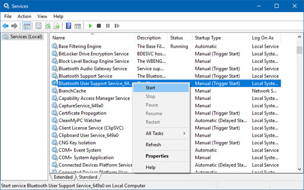

3] Check essential Bluetooth services
This solution requires you to make sure the following services are set to Automatic (Delayed) and running in Windows Services manager:
- Bluetooth
- Bluetooth Device Monitor
- Bluetooth OBEX Service
- Bluetooth Support Services
To enable these essential services on your Windows 11/10 computer, do the following:
- Open Services console.
- Locate the mentioned services one by one, and if any of the service is not running or not set to Automatic (Delayed), double-click on the service, set its Startup type to Automatic (Delayed) from the drop-down list.
- Apply the changes.
- Click on Start button to immediately start the service.
- Finally restart your PC.
If the issue is unresolved, try the next solution.

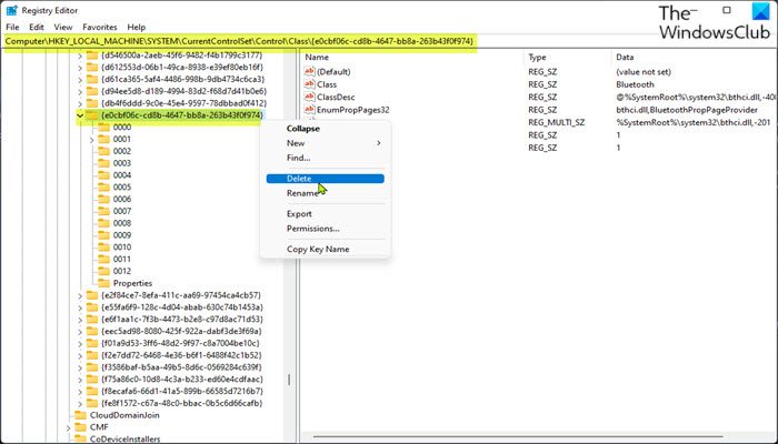

6] Modify Registry
HKEY_LOCAL_MACHINE\SYSTEM\CurrentControlSet\Control\Class\{e0cbf06c-cd8b-4647-bb8a-263b43f0f974}
- At the location, on the left navigation pane, right-click the {e0cbf06c-cd8b-4647-bb8a-263b43f0f974} folder entry.
- Select Delete on the context menu.
- Click OK to confirm the delete operation.
- Exit Registry Editor.
- Restart PC.
