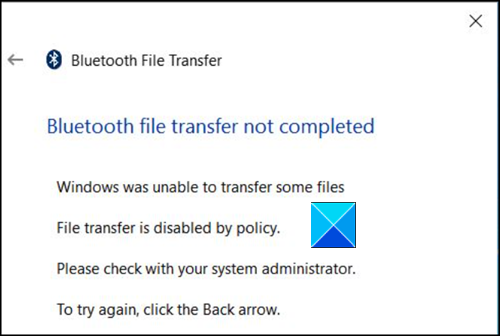

You may see a Waiting for connection message or Bluetooth file transfer not completed, Windows was unable to transfer some files, File transfer is disabled by policy message.
Bluetooth Transfer not working in Windows 11/10
Cannot send or receive a file via Bluetooth in Windows 11/10
If you are unable to or cannot send or receive a file via Bluetooth in Windows, and if you see a Waiting for connection message or Bluetooth file transfer not completed, File transfer is disabled by policy message, then one of these fixes is sure to help you.

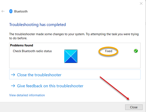

1] Use Bluetooth Troubleshooter
- Go to Windows Settings.
- In its Search bar type troubleshoot to select troubleshoot settings.
- Click the Additional Troubleshooters link.
- Go to the Find and fix other problems heading, choose Bluetooth (find and fix the problem with Bluetooth devices).
- Hit the Run the troubleshooter button.
The Bluetooth Troubleshooter will begin scanning for the issues and fix them successfully.

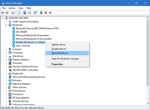

3] Reinstall Network adapter
- Open Device Manager from the WinX Menu
- Expand Bluetooth
- Select the Bluetooth adapter for your system
- Right-click on it
- select Uninstall
- Restart your PC
- Use the Scan for hardware changes option from the same menu.
Let Windows install the driver.
