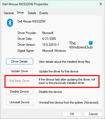

10] Rollback your Bluetooth driver or uninstall the latest Windows Update
If the issue started occurring after a specific Windows Update, it means your Bluetooth driver was updated along with the Windows Update. In that case, you can uninstall the latest driver and revert to the previous one. To do so, follow the steps below:
- Press the Win + X keys and select the Device Manager.
- When the Device Manager opens up, locate your Bluetooth device driver.
- Right-click on it and select Properties.
- Click on the Driver tab and see if the Roll Back option is available. If yes, click on it. This process will uninstall the latest driver update and install the previous version of your Bluetooth device driver.
Now, check if the issue persists. If yes, uninstall the latest Windows Update.

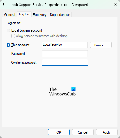

12] Configure the Bluetooth Support Service
If restarting the Bluetooth Support Service does not fix your problem, configure it by following the steps given below and check if it helps.
- Open the Service Management window by following the process explained in the previous solution.
- Locate the Bluetooth Support Service. Double-click on it to open its properties.
- Select the Log On tab.
- Now, select This Account and type Local Service in the required field.
- Delete the password in the Password and Confirm Password fields.
