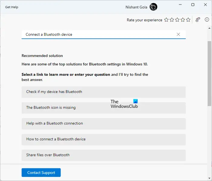

4] Run Windows Bluetooth troubleshooter
Run Windows Bluetooth troubleshooter and see if it helps you. You can access it via the Settings Troubleshooters Page or the Get Help app.
