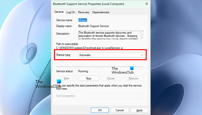

2] Restart Bluetooth Support Service
The Bluetooth Support Service is responsible for the proper functionality of the Bluetooth devices connected to a PC. If this service has been stopped or not working properly, your Bluetooth devices will not work. In your case, restarting the Bluetooth Support Service can fix the issue. The steps to do that are as follows:
- Press Win + R keys.
- When the Run command box appears, type services.msc and click OK.
- When the Services app opens, look for Bluetooth Support Service.
- Right-click on it and select Restart.
- After restarting the Bluetooth Support Service, double-click on it to open its properties.
- Select Automatic in its Startup type.
- Click Apply and then OK.

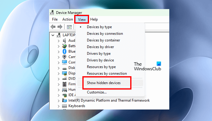

3] Enable hidden devices in the Device Manager
It might be possible that the Bluetooth driver is hidden in the Device Manager. You can check this by enabling the hidden devices in the Device Manager. If the Bluetooth driver appears, update or uninstall it and restart your computer. The steps to do this are given below:
- Press Win + X keys and select Device Manager.
- In the Device Manager, go to “View > Show hidden devices.”
- Now, check if the Bluetooth driver appears in the Device Manager. If not, select the Bluetooth node and then go to “Action > Scan for hardware changes.” If this brings the Bluetooth driver, right-click on it and select Update driver.
- Select the “Search automatically for drivers” option.
- Let Windows update your Bluetooth driver. After the update process gets completed, check if the problem is fixed.
If the problem still persists, right-click on your Bluetooth driver and select Uninstall device. After uninstalling the Bluetooth driver, restart your computer. After restarting your computer, Windows will try to install the latest version of the Bluetooth driver automatically.
This should fix your problem. If not, try the other solutions.
