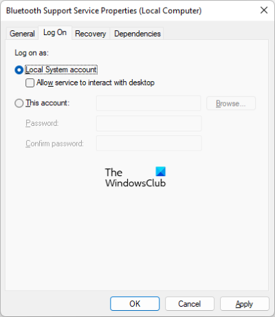

4] Switch Bluetooth Support Service to the Local System account
If the above methods do not solve your issue, try switching Bluetooth Support Service to the Local System account.
Follow the steps below:
- Launch the Services app.
- Right-click on the Bluetooth Support Service and select Properties.
- Now, under the Log On tab, select Local System account.
- Click Apply and then OK.
