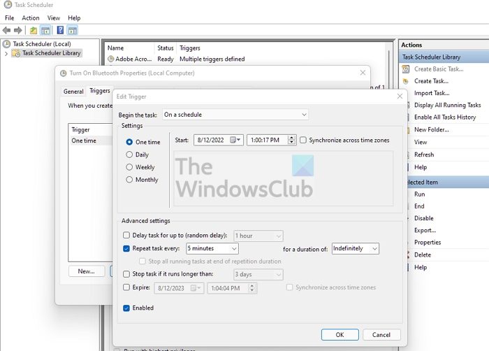

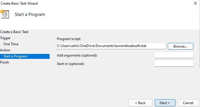

4] Use the Task scheduler
If nothing works and your Bluetooth keeps turning off, you need to connect with tech support. It could be a hardware issue. However, if you want a temporary fix, you can choose to run the below-mentioned script below using the Task scheduler.
- Open Notepad, type the following command and save the file with the BAT extension.
[SC config bthserv start] = auto [Enter]] [SC config bthHFSrv start = auto [Enter]]
- Type Task manager in the Start menu, and click to open the task manager
- Click on Create Basic Task, and set it to run the BAT file
- Once done, open the advanced section, set it to one-time execution, but repeat the task every 5 minutes and run it indefinitely.
- Apply the changes, and let the program run, ensuring Bluetooth service stays on and is not turned off.
