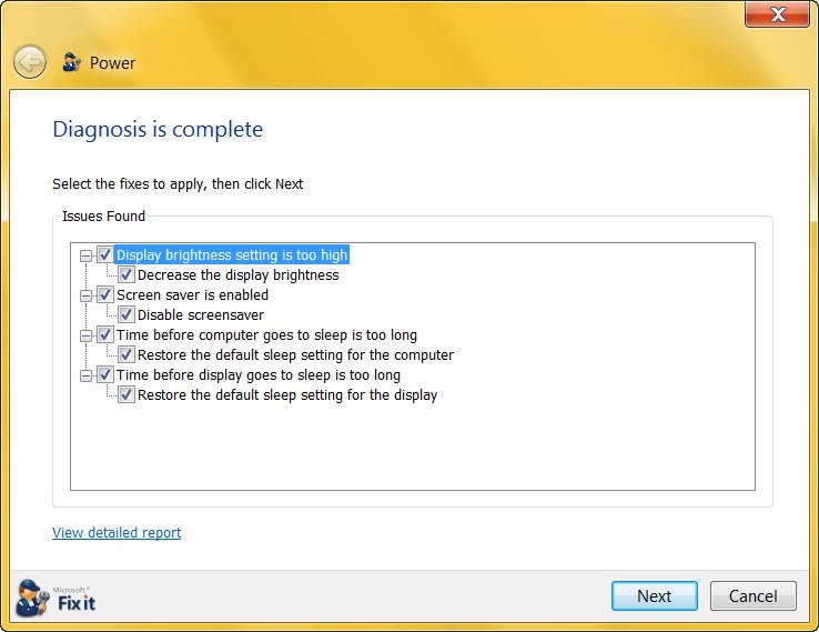

MSDT-based Power Troubleshooter
You can let it scan and fix issues automatically or choose and select which settings you want fixed. Once you select an option, the Power Troubleshooter will start the scan and present you with its findings.
Once you click Next, it will fix the issues and present you with a report.
This Power Troubleshooter fixes the following:
- Wireless adaptor is not optimized for power saving
- Screen saver is used instead of setting the computer to enter sleep mode
- Period of time before the computer goes to sleep is set too long
- Minimum processor state is set too high
- Display brightness is set too high
- Power plan is not set to the most efficient power plan.
