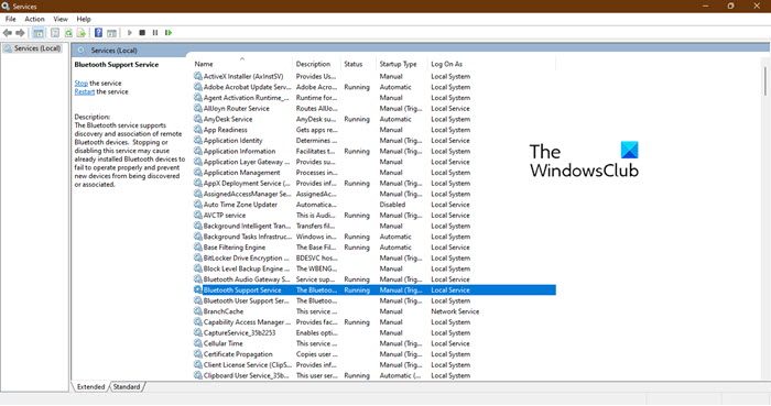

4] Restart Bluetooth Support Service
The issue can be caused due to some kind of glitch in the Bluetooth Support Service that’s present on your computer. We need to restart the service and see if that helps. Follow the given steps to do the same.
- Open Services by searching it out from the Start Menu.
- Look for Bluetooth Support Service, right-click on it and select Restart.
- Wait for the process to complete then click Ok if prompted.
Now, go ahead and check if Bluetooth is available.
