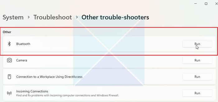

3] Run the Bluetooth troubleshooter
Running the Bluetooth troubleshooter can fix this issue. To do so, follow the given steps below.
- Right-click the Windows button and select the Settings option from the list.
- From the left-side window panel, select the System and from the right-side panel, click on Troubleshoot.
- Now select other trouble-shooters. Here, you must scroll down to Bluetooth and click the Run button.
If there is any issue, the troubleshooter will detect and fix it for you and resolve your issue.

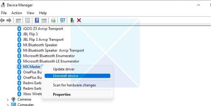

6] Reinstall Bluetooth Driver
Reinstalling Bluetooth Driver has a chance to fix the Bluetooth device paired but not connected with the Windows issue. For this, you must first uninstall all the previously installed Bluetooth drivers. Follow the steps below to uninstall all the previous versions’ Bluetooth drivers.
- Right-click on the Windows button and choose device manager from the list.
- Now find the Bluetooth option in the Device Manager and click it to expand it.
- Right-click the Bluetooth drivers and select uninstall the device. On the pop-up interface, check to Delete the driver software for this device.
- Now click the Uninstall button to confirm the uninstallation process.
Now reboot your laptop, visit the official site of the Bluetooth software, download it and install the latest compatible version and install it manually, and check whether your issue is resolved.
