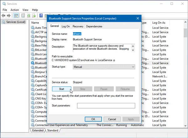

1] Check Services
There is a Bluetooth-related service, which runs and helps you use Bluetooth. If that service has been stopped due to any reason, you might get this problem on your computer. To check that, open Services. You can take the help of Cortana, or you can use Run prompt as well. Press Win + R, and type services.msc and hit the Enter button. Search for Bluetooth Support Service and double-click on it to open Properties.
Make sure the Service status is showing as Running. If it is showing as Stopped, you need to click the Start button.
Also, check that the Startup type is set to Manual.

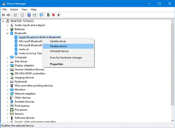

2] Restart Bluetooth Driver
If your Bluetooth driver is lagging in the background, you might not be able to connect any Bluetooth device with your computer. You should restart your Bluetooth driver and check if it solves your problem or not. To get started, press Win + X and select Device Manager. Expand the Bluetooth menu > right-click on the Bluetooth driver > select Disable device.
It will ask for confirmation, where you need to select Yes. Then, again right-click on the same driver and select Enable device. You may also select Action > Scan for hardware changes option to get the latest change.
