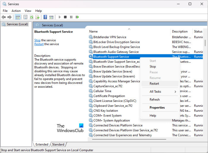

5] Check the status of the Bluetooth Support Service
The Bluetooth Support Service supports the discovery and association of remote Bluetooth devices. If this Service is disabled or stopped, you will experience issues with your Bluetooth devices or new Bluetooth devices will not be discovered by Windows.
Check the status of the Bluetooth Support Service. If it is stopped, start it. If it is already running, restart it. The steps to do so are written below:
- Open the Windows Services Manager.
- Scroll down and locate the Bluetooth Support Service.
- If its status shows stopped, right-click on it and select Start. If its status shows running, right-click on it and select Restart.
If the Service is stopped, perform one more step after starting it. Open its properties and select Startup type as Automatic under the General tab. When you are done, click Apply and then click OK. Restart your computer.
