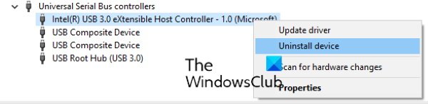

3] Uninstall and reinstall all the Universal Serial Bus Controllers
The USB controller enables a computer to communicate with connected USB devices. When USB devices do not work properly or you see a yellow warning sign along with a “Unknown Device” message in the Device Manager, reinstalling USB Controllers may resolve the issue.
We have explained the process below:
- Launch the Run dialog box by pressing Win + R keys. Now, type
devmgmt.mscand click OK to launch the Device Manager. - In the Device Manager, expand the Universal Serial Bus Controllers node.
- Right-click on the USB Controller and select Uninstall device. You have to uninstall all the USB Controllers available there one by one.
- After uninstalling the Controllers, restart your computer.
- After a restart, Windows will automatically install the latest USB Controllers on your system.
Now, connect your USB device and check whether your system recognizes it.
