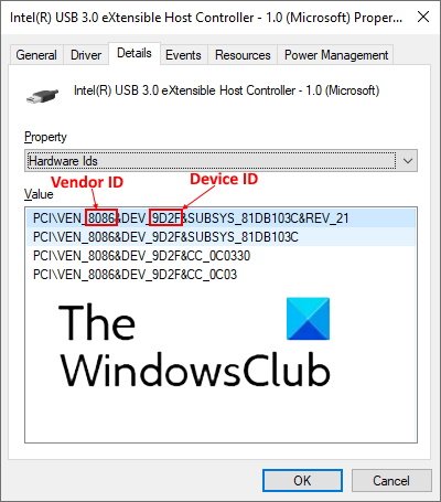

How do I identify an unknown USB device?
You can identify the unknown USB device in your computer’s Device Manager. The method we are going to show you will help you determine the vendor ID and device ID of the unknown device. If you do not know the vendor or device ID of your device, it may be challenging to download the correct drivers.
Follow the steps below:
- Launch the Device Manager.
- Look for the unknown device. The unknown device is displayed in the Device Manager with a yellow exclamation icon.
- Once you find the unknown device, right-click on it and select Properties.
- A new window will open in which you have to click on the Details tab.
- Now, click on the drop-down menu under the Property section and select Hardware Ids from the list.
- Then the Device Manager will display the data containing both vendor ID and device ID. The text of four characters followed by VEN represents the vendor ID and the text of four characters followed by DEV represents the device ID. Refer to the above screenshot for details.
Now, you can download the drivers for the unknown device directly from the manufacturer’s website.
