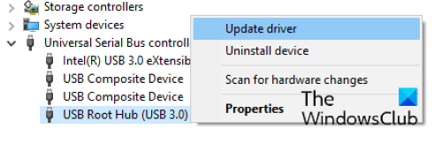

6] Update USB Root Hub
If reinstalling the USB Controllers did not work, you can try updating the USB Root Hub. Follow the instructions below:
- Launch the Device Manager.
- Expand Universal Serial Bus Controllers node.
- Right-click on the USB Root Hub and select Update driver.
- Select the Search automatically for drivers option. After that Windows will search for the latest version and install it on your system.
Check if this solves your issue or not.
If it does not work, right-click on the USB Hub again and select Update driver. Now, this time, you have to select the Browse my computers from drivers option. After that, select the Let me pick from the list of available drivers option and then choose the Generic USB Hub (if available) from the list displayed. Now, click Next and follow the on-screen instructions. After the installation gets completed, restart your system.
Hopefully, this should fix the error.
