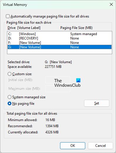

4] Disable the paging file
Some users have found the paging file the culprit of the problem. According to them, the paging file was configured on another drive than the C drive. When they disabled the paging file, the issue was fixed. You can also try this. Disable the paging file and see if it helps. The steps to do this are as written below. Before you proceed, we suggest you create a System Restore Point.
- Click on Windows Search and type Advanced System Settings.
- Select View Advanced System Settings from the search results.
- The System Properties window will appear.
- Under the Advanced tab, click on the Settings button in the Performance section.
- When the Performance Options window opens up, select the Advanced tab and click the Change button under the Virtual memory section.
- Deselect the Automatically manage paging file size for all drives checkbox.
- If the paging file is configured on another drive partition, you will be able to see its size next to that drive partition name.
- Select the drive partition and click on the No paging file radio button.
- Click Set.
- Click OK.
Now, you should be able to delete the partition using the Diskpart utility. After deleting the partition, you can enable the paging file again.

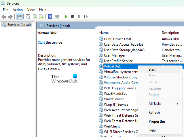

Can I restart the Virtual Disk Service?
Virtual Disk Service (VDS) is a service on Windows computers that performs queries and configuration operations at the request of users and applications. If Virtual Disk Service is not running on your system, you can start it via the Services Management window. The steps for the same are explained below:
- Press the Win + R keys to launch the Run command box.
- Type services.msc in the Run command box and click OK. This will open the Services Management window.
- In the Services Management window, locate the Virtual Disk service.
- Right-click on it and select Start.
If you want the VDS to start automatically, double-click on it to open its properties. Under the General tab, select Automatic in the Startup type drop-down and click OK.
