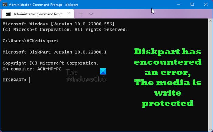

Some users reported getting an error message saying “Diskpart has encountered an error, The media is write protected” after using the clean or clean all commands in DiskPart. Additionally, this problem may also appear when mounting SD cards, HDDs, SSDs, SanDisk drives, among others. In case you’re dealing with the same issue on your computer, this post might help you fix it.

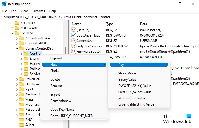

- If you do not see the StorageDevicePolicies key in the following location, you need to create it.
- To do so, right-click on Control and then select New > Key.
- Then name it StorageDevicePolicies.

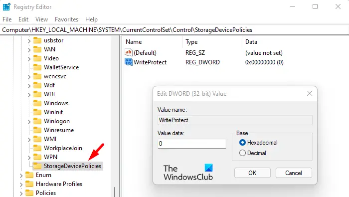

- You now need to create a new 32-bit DWORD value named WriteProtect.
- For this, right-click on StorageDevicePolicies, choose New > DWORD (32-bit) Value, and then name it WriteProtect.
- Click twice on the newly created WriteProtect key, and then when the popup menu appears, change the Value data to 0.
- Lastly, click OK to save the changes.
Now close the Registry Editor window and check if you are able to access the storage device and data.

- Run Command Prompt as an Administrator. To do so, open the Run window. Once it opens, type cmd in the search bar and press the key combination Ctrl+Shift+Enter.
- In the Command Prompt window, type diskpart and press Enter.
