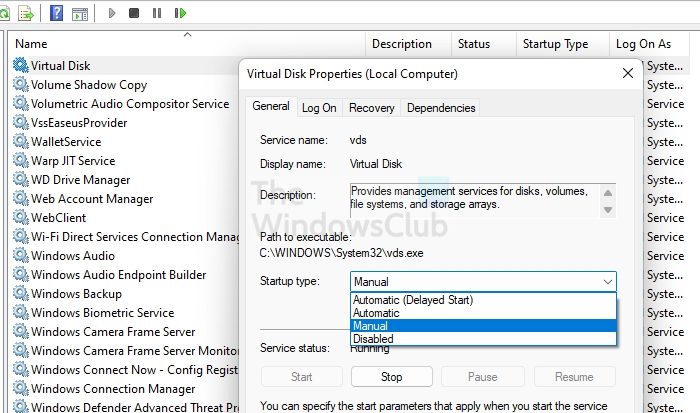

1] Autostart Virtual Disk Service (VDS)
VDS service is set to manual start, i.e., it is only started when another program requests it. It can be Windows or any other program connected with virtual services. It is possible that when you are trying the Diskpart tool, the service did not start, and hence you get the error— The service failed to initialize.
To start the service, follow these steps:
- Open Run prompt using Win + R
- Type services.msc and press the Enter key
- Locate Virtual Disk Service in the services management console and check the status
- If it’s not running, right-click and click on the Start option
- Make sure that its Startup type is set to Manual. which is the default Windows setting.
- Apply the changes, and click on the OK button to close it.
Restart your Windows PC and check if the service errors are not there anymore.
You can also quickly start the VDS service by running the command net start vds from an elevated Windows Terminal.
Read: Disk Management not connecting to Virtual Disk Service

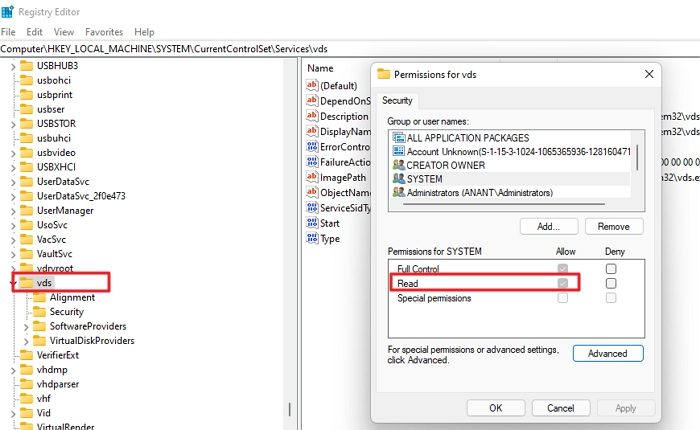

2] Check Registry permission for Application Packages
One of the suggestions by a user in the forum, based on his experience, was to make sure one of the registry components related to VDS has read permissions. If that is not so, the error will show up.
- Type registry in the Start menu, and click on the Registry Editor listing in the search result
- If prompted by UAC, click on the Yes button
- Next, navigate to the following path
HKLM\SYSTEM\CurrentControlSet\Services\vds
- Right-click on the VDS folder and click on the Permissions option
- Select each group or user name and ensure all have Read permission or the Special permissions.
If the permission is missing, you need to add your account and add permissions to it. It will ensure that when you execute the command the problem doesn’t occur.
Apart from the above two methods, you can also run SFC, and DISM commands to rule out the possibility of system file corruption.
