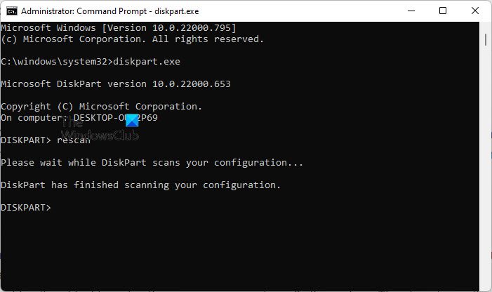

2] Refresh the object by using the RESCAN command
The Rescan command in a Diskpart utility is used to locate newly added disks to a computer. You can run the rescan command to detect the changes in your disk configuration. On running this command, the Diskpart utility will scan all the attached disks for configuration changes and also update other information, like basic volumes, file systems, and drive letters. According to the error message, refreshing the object by using the rescan command can fix the problem. The steps to run the rescan command via the Diskpart utility are written below:
- Launch Comand Prompt as administrator.
- Type Diskpart and hit Enter.
- Type rescan and hit Enter.
After the completion of the above command, check if you can create a partition using the Diskpart utility. If you receive the same error message while creating a partition via Diskpart, try the next solution.

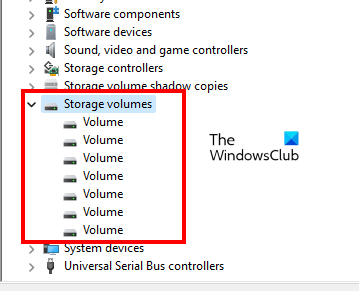

3] Delete the Unknown device from the Device Manager
The number of volumes created on your hard disk is also shown in the Device Manager under the Storage Volumes branch. If Windows encounters an error with a particular storage volume, you will see a warning sign for that storage volume, or that volume is labeled as an “Unknown device” in the Device Manager. Open the Device Manager and uninstall the volume labeled as “Unknown device.” The steps for the same are explained below:
- Press the Win + X keys and select Device Manager.
- When the Device Manager opens up, expand the Storage Volumes branch. If you do not see the Storage Volumes branch, go to “View > Show hidden devices.”
- Right-click on the device labeled as “Unknown device” and select Uninstall device.
- Close the Device Manager.
Now, you should be able to create a new partition using the Disk Management console or the Diskpart utility. If this does not work, restart your computer and try again. If the problem persists, try the next solution.

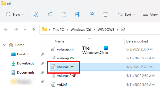

4] Check if the volume.inf file is missing
Another cause of the problem is the missing volume.inf file from the Inf folder. To check this, open the Run command box and type the following command. After that click OK.
%Systemroot%\inf
The above command will open the Inf folder. Now, check if the volume.inf file is present there. If not, follow the instructions explained below.
Open an elevated Command Prompt. Click Yes if you receive a UAC prompt. When the Command Prompt appears on your screen, type the following command and press Enter.
sfc /verifyonly
If you see the “problems were found” message after the above command is executed successfully, type the following command and press Enter.
sfc /scannow
Now, open the Inf folder by using the Run command box as explained above. Your system should show the volume.inf file. If you do not find the volume.inf file in the Inf folder, you have to copy it from another healthy computer and then paste it into the Inf folder. This should fix the issue. Do note that, the computer from which you copy the volume.inf file should be running on the same version of Windows OS and have the same CPU architecture as yours.
