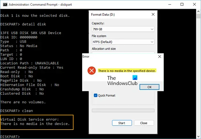

Are you experiencing “There is no media in the specified device” error when trying to format your USB drive? Many users have complained of getting this error while formatting their USB drive using Windows built-in Diskpart or the Format UI tool.
One of the affected users says:
I have a Kingston USB drive that seems does not working well so I decide to reformat it completely. Run Diskpart as administrator and input these commands: list disk > select disk 1 (where 1 is my Kingston drive) > clean. And I got this error: Virtual Disk Service error, There is no media in the device. It does not allow me to run format command as well. What should I do to get rid of this issue?
Another user commented:
I tried to reformat my USB drive with HP USB Disk Storage Format Tool, but it says that there is no media in the specified device. It doesn’t even display total size and the free size of the USB. Then, I tried two other software that could reformat USB but the other one couldn’t even see the USB and the other one couldn’t reformat it. What do I do now?

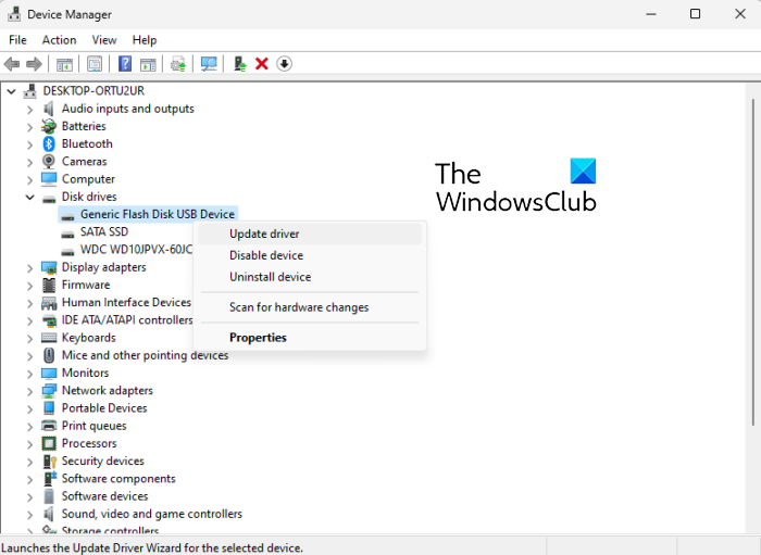

2] Update or Reinstall USB Device Driver
You can try updating your USB device driver and see if it works or not. For some users, this method was able to fix the error and might just work for you as well. Here’s how you can do that:
- Firstly, press Windows+X and then select Device Manager to open the app.
- Now, expand the Disk drives drop-down menu option.
- Next, right-click on your USB device and press the Update driver option.
- After that, follow the prompted instructions to update the driver. Windows will now attempt to update your USB driver.
- Once done, try reconnecting your USB and see if the error is gone or not.

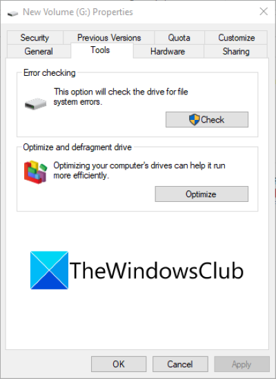

4] Run Windows built-in disk error-checking tool
There is no media in the specified device error might occur if there are file system errors, bad sectors, or storage media corruption on your USB driver. Hence if the scenario is applicable, you can try fixing the file system errors using the Windows built-in disk error-checking tool. Here’s how you can do that:
- Firstly, open Windows Explorer using the Windows+E hotkey and then right-click on the problematic USB drive showing the error.
- Now, click on the Properties option from the appeared context menu.
- Next, move to the Tools tab and press the Check button.
- Next, checkmark the Automatically fix file system errors and Scan for and attempt recovery of bad sectors options and click on the Start button. Or, follow whatever instructions you are prompted.
- Once all the logical errors, bad sectors, or any other file system errors are fixed on the USB drive, check if the error is resolved.
