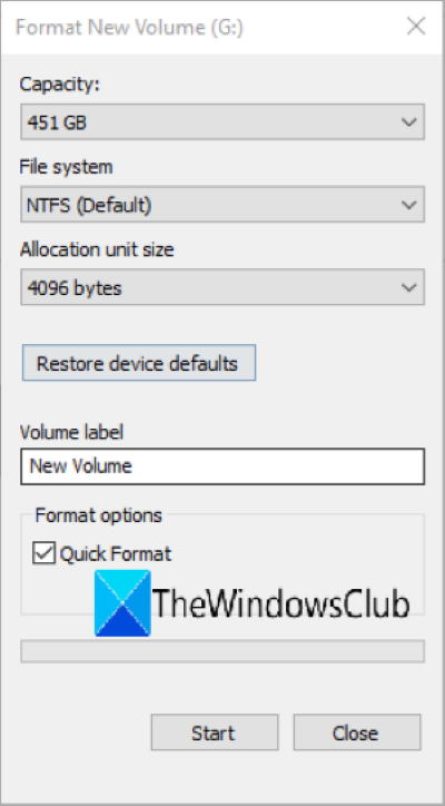

6] Format the USB drive
If the above solutions don’t work, formatting the USB drive that is showing 0 bytes is the last resort. Before that, you can try recovering files from the USB drive.
Format the USB drive by right-clicking the USB drive and clicking the Format option. Then, set up various options like file system, capacity, allocation unit size, etc., and click the Start button. This will fix corruption in the storage drive and then you can check if the issue is gone.
