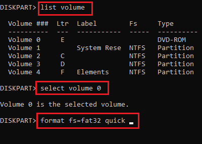

3] Change the format of the external drive from RAW to something else
The RAW format gets created when certain files in an external drive are corrupt. A hardware issue could also cause it, but in that case, we cannot resolve the problem ourselves. In this situation, we would have to format the File System to either FAT or NTFS.
Press Win + R to open the Run window and type the command diskpart.
In the elevated Command prompt window that follows, type the following commands and press Enter after each one to execute them.
list volume select volume x format fs=fat32 quick exit.
Where x is the drive letter of the external drive to be formatted.
Once done, you could proceed with whatever you intended to do with the Diskpart command initially.

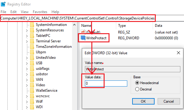

4] Remove Write protection via Registry
The Registry Editor method could be used to resolve the issue. The procedure to do so is as follows:
Press Win + R to open the Run window. Type the command regedit and press Enter to open the Registry Editor window.
Navigate to the following path in the Registry Editor:
HKEY_LOCAL_MACHINE\SYSTEM\CurrentControlSet\Control\StorageDevicePolicies
On the right-pane, double-click on WriteProtect to edit its properties.
Change the value of Value Data to 0.
Click on OK to save the settings and restart the system.
If the above-mentioned solutions don’t work, the cause could be a hardware problem. You could consult a support technician.
