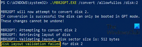

MBR2GPT disk layout validation failed
You’ll encounter this error because MBR2GPT program only applies to Windows 10 version 1703, Windows 11 or later. So, if you’re running the tool on Windows 10 version earlier than v1703, this MBR2GPT disk layout validation failed error will occur.
Solutions
- If you are using a computer running Windows 7, 8, or 8.1, you can upgrade to a currently supported version/build of Windows 11/10.
- If you have installed earlier versions of Windows 10 such as versions 1507, 1511, and 1607, you must run the tool while booting into later versions of Windows 10 or Windows 11 and perform an offline conversion.
- If the MBR disk has 4 partitions the conversion will fail and you’ll receive this error. In this case, try deleting one partition and see if that helps.
