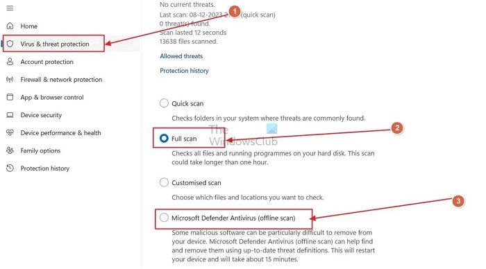

3] Run an antivirus scan
If you are not sure whether the program is malicious or not, we won’t recommend disabling the security feature yet. Instead, run a full scan and see if you can find anything. If you have a third-party antivirus, scan your system using it; if not, follow the steps mentioned below to use the built-in scanner.
- In Windows Security, go to Virus & threat protection.
- Now, click on Scan options.
- Select Microsoft Defender Antivirus (offline scan) and click on Scan now.
Let it scan and give you the result. If it finds anything malicious, it will respond, and then you can take action accordingly.
