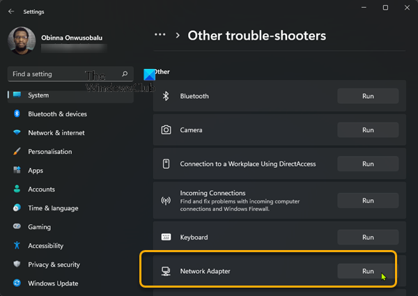

To run Network Adapter Troubleshooter on your Windows 11 device, do the following:
- Press Windows key + I to open the Settings app.
- Under the Other section, find Network Adapter.
- Click Run button.

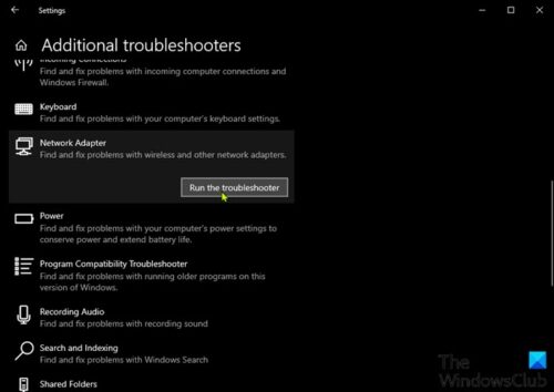

To run Network Adapter Troubleshooter on your Windows 10 PC, do the following:
- Go to Update and Security.
- Scroll down and click on Network Adapter.

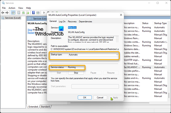

4] Turn on WLAN AutoConfig service
You may encounter the error in view if the WLAN AutoConfig service isn’t started or turned off or the Windows Wireless Service is not running on the local computer. In this case, to resolve the issue, you need to turn on the WLAN AutoConfig service.
To turn on the WLAN AutoConfig service on your Windows 11/10 PC, do the following:
- In the Run dialog box, type services.msc and hit Enter to open Services.
- In the Services window, scroll and locate the WLAN AutoConfig service.
- Double-click on the entry to edit its properties.
- In the properties window, click the drop-down on the Startup type and select Automatic.
- Next, make sure the Service status is started and running.
- Click Apply > OK to save changes.
- Exit Services console.
- Restart PC.
