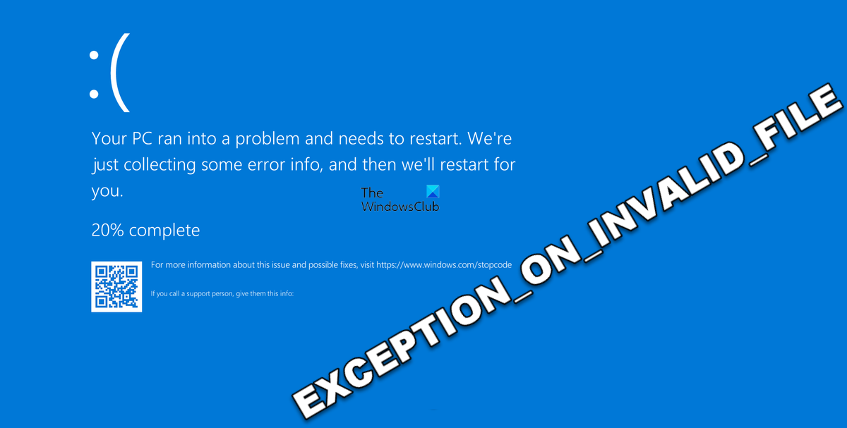

Some PC users have reported the issue whereby when booting their system or while using the computer, the Windows 11 or Windows 10 system randomly crashes and displays the EXCEPTION_ON_INVALID_FILE Blue Screen error. This post provides the most applicable solutions to fix this error.
Upon investigation, it was discovered you may encounter this error due to one or more of the following reasons.
- Bad sectors on the drive.
- Boot Configuration Data (BCD) is corrupted, misconfigured, or missing.
- Corrupted system files.
- Windows bugs.
- Outdated drivers running in compatibility mode.
If you get the EXCEPTION_ON_INVALID_FILE Blue/Black Screen of Death (BSOD) error when you boot or during normal use, your Windows 11/10 computer crashes, then you can try our recommended solutions presented below in no particular order and see what works for you in fixing this error.
