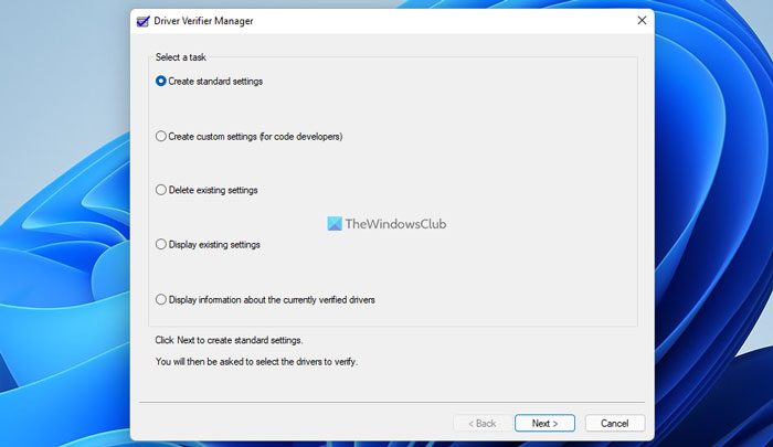

2] Use Driver Verifier Manager
You can use the Driver Verifier Manager on your computer to find the problematic driver on your Windows PC. Whether it is a newly installed or an existing driver, you can find the faulty one.
The tool allows you to verify any category of drivers to verify:
- Unsigned drivers
- Drivers built for older versions of Windows
- All drivers
- Select specified drivers only.
Unsigned drivers are usually suspected, and this tool can not only help you identify failed unsigned drives but also other signed drivers.

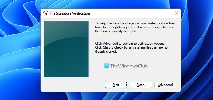

3] Use File Signature Verification Tool
The built-in File Signature Verification Tool is yet another utility you can use to find the problematic driver on your PC. It will help you identify Unsigned & Digitally Signed Drivers.

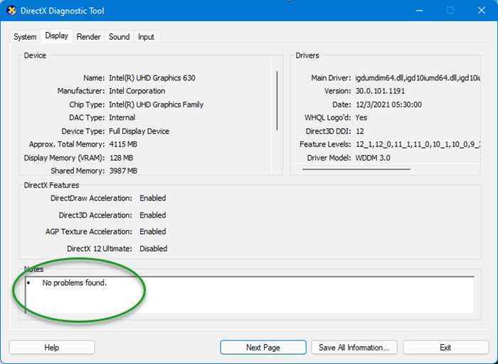

4] Use DirectX Diagnostic Tool
The DirectX Diagnostic Tool is designed to help you troubleshoot DirectX-related issues. If you recently installed a driver for making your games smoother and started getting the Blue Screen error after that, you can use the DirectX Diagnostic Tool. If the Diagnostic Tool flags an unsigned driver, updating the driver might solve your problem. You can typically find the latest driver for your hardware on the support section of the manufacturer’s website. Make sure you have the 64-bit driver for your 64-bit PC and the driver version is compatible. You may have to check your hardware configuration to figure this out.
