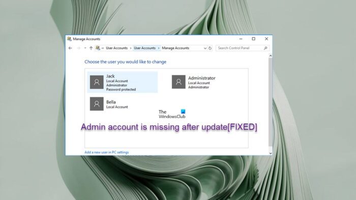

Some PC users have reported that after completing a system update, they noticed they have lost administrator rights, or the admin account is missing on their Windows 11 or Windows 10 computer. If you’re faced with a similar issue, then this post is intended to help you with suggestions you can try to resolve the issue on your device.
Admin account is missing after Windows Update
If after you update your Windows 11/10 PC to the latest version/build and the administrator account is missing, you can try our recommended solutions below in no particular order and see what helps you resolve this issue on your system.

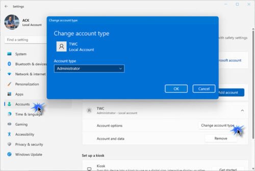

Windows 11
- Press Windows key + I to open Settings.
- Click Accounts on the left navigation pane.
- On the right side, select Family and other users.
- Now locate the user account and click on it.
- Click on the Change account type button that appears.
- In the popup, change the Account type accordingly.
- Click OK.
- Exit the Settings app.

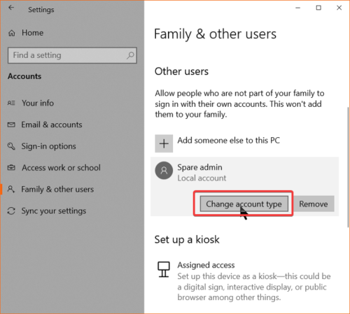

Windows 10
- Select Accounts from the menu.
- Next, select Family & other users.
- Now, under Your family or other users’ menu, find the user account you want to modify and click on it.
- Click on the Change account type button.
- On the next screen, select the preferred user account type from the dropdown.
- Click the OK button.
