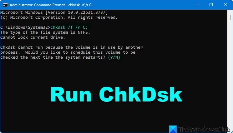

8] Run CHKDSK
If the hard drive has its file integrity compromised, you may experience any of these errors. In this case, it is possible to run the built-in Windows CHKDSK utility to scan the disk to fix the file system errors, and repair bad disk sectors.
