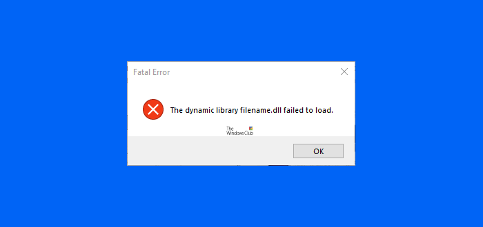

On Windows startup, if your system cannot or is unable to load a required dll file and you see a message – Failed to load DLL, then this post will help you. The error message could be:
- The dynamic library dll failed to load.
- Failed to load dll library.
This error can occur if Windows OS fails to locate the DLL library which the system needs to access during startup. It could also occur if could happen if the DLL is not in a directory specified in the path or if the DLL has gone missing or corrupted. This error is commonly seen if you have removed a malware infection – but a DLL file has been left behind.
