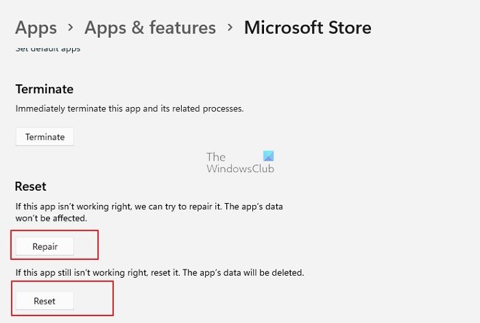

3] Reset/Reinstall Microsoft Store
This solution only applies if the error occurs on your Windows 11/10 gaming rig. You can easily reset the Microsoft Store via the Settings app or using the wsreset.exe command. If you’re still unable to download/install games on your device, you can reinstall the Windows Store using PowerShell by following these steps:
- Press the Windows key + X to open the Power User Menu.
- Tap A on the keyboard to launch PowerShell (Windows Terminal) in admin/elevated mode.
- In the PowerShell console, type or copy and paste the command below and hit Enter.
Get-AppxPackage -allusers Microsoft.WindowsStore | Foreach {Add-AppxPackage -DisableDevelopmentMode -Register “$($_.InstallLocation)\\AppXManifest.xml”}
After the command executes, restart your computer and boot, and see if the issue at hand is resolved. In addition, you can repair/reset the Xbox app on your PC.
