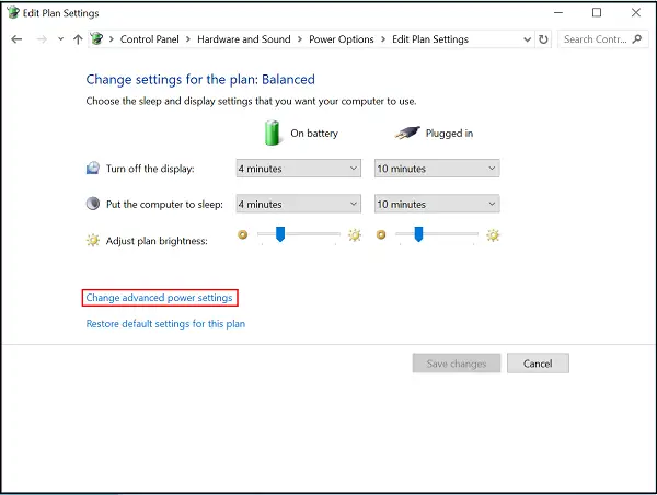

4] Disable USB selective suspend setting
If the methods mentioned above do not yield the desired results, try disabling the USB selective suspend setting. Here’s what you can do.
Open Power Options from the Control Panel and navigate to Additional power settings. Next, click on the ‘Change plan settings’ option adjacent to your selected power plan.
Then go to ‘Change advanced power settings and under USB settings, find USB selective suspend setting, and set it to Disabled.
Click Apply and exit.

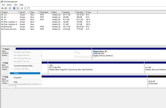

5] Enable and Format the Drive in Disk Management
You will need to check if the drive is in Offline mode using the built-in Disk Management tool. Open Windows Search (Win +S) and type disk management. Once the tool appears in the list, click to open.
You should be able to see all connected drives in the list. The one that is not available on the PC will look greyed out. Right-click on it and choose to enable. Once you have done that, you can format the drive so it can finally appear in Windows Explorer.
