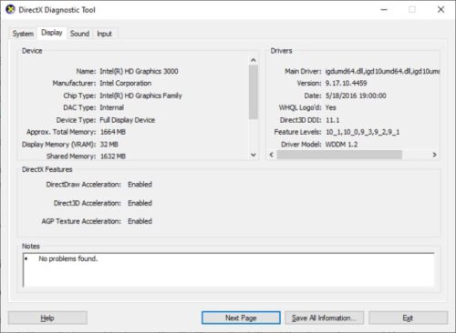

2] Run DirectX Diagnostic Tool (DxDiag)
If you’re having problems getting a game or movie to play properly on your Windows 11/10 device, the DirectX Diagnostic Tool can help you pinpoint the likely culprits.
This solution requires you to troubleshoot the DirectX error using DirectX Diagnostic Tool (DxDiag).

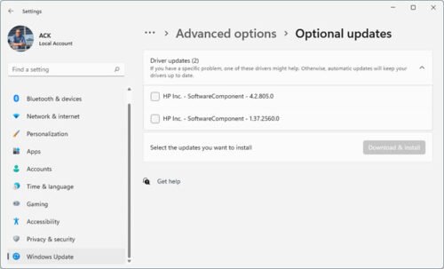

4] Update the graphics driver
This solution requires you to update the graphics driver on your system and see if that helps. You can manually update drivers via Device Manager if you have already downloaded the .inf or .sys file for the driver, or update the driver via Command Prompt. You can as well get the driver updates on the Optional Updates section under Windows Update or you may also download the latest version of the driver from the manufacturer’s website or automatically update your drivers using any of the free Driver Update Software for Windows 11/10 PC.
However, if the latest drivers are installed, you can roll back the driver or download and install an earlier version of the driver.
If both updating and/or rolling back the driver didn’t work, you can uninstall the graphics driver, and then restart your PC – on boot, Windows will scan for hardware changes and automatically reinstall the generic driver for the display/video device which in some cases is sufficient enough for the graphics to function without issues.

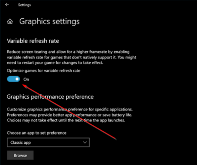

7] Disable Variable Refresh Rate and Hardware-accelerated GPU Scheduling
This solution requires you to disable Variable Refresh Rate for games and also disable Hardware-accelerated GPU Scheduling on your Windows 11/10 gaming PC.
Try the next solution if the issue persists.

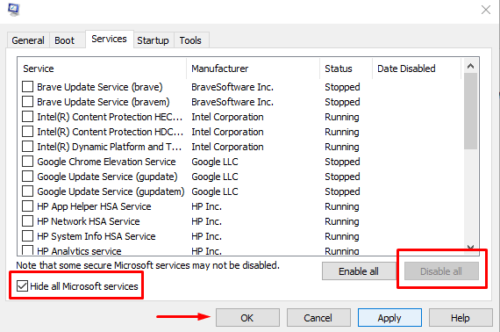

9] Troubleshoot in Clean Boot state
Background programs can sometimes interfere with the games you’re playing causing them to crash and consequently throw errors. So, be sure to close all the background programs that you don’t need while gaming – do that prior to launching your game. Likewise, unnecessary system and cache files, processes, services present or running on your computer can trigger this error. In this case, you can troubleshoot in Clean Boot State and see if the issue at hand is resolved. Otherwise, try the next solution.
