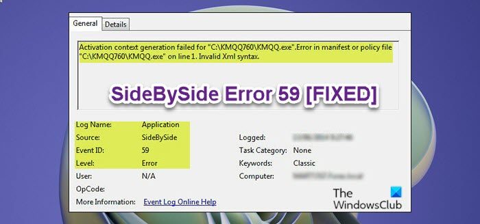

On your Windows 11 or Windows 10 computer, while analyzing Event Logs in Event Viewer, you may notice the Event ID 59 error with the description Activation context generation failed. When this manifest or policy file error occurs, mostly when you launch certain apps and the app crashes, it usually goes unnoticed since there’s no adverse effect on your system. Nonetheless, this post provides suggestions you can try to fix the SideBySide Error 59, so that your system functionality is not impacted down the road.
Activation context generation failed for ’C:\KMQQ760\KMQQ.exe”.Error in manifest or policy file “C:\KMQQ760\KMQQ.exe” on linel. Invalid Xml syntax.

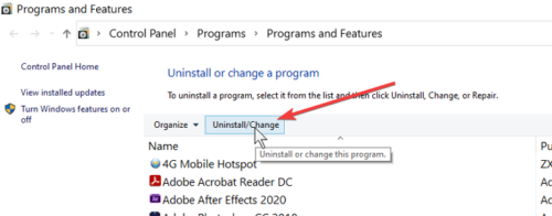

- Uninstall Bing Bar (if applicable)

- Uninstall and reinstall the app

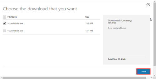

4] Install missing Microsoft Visual C++ Redistributable Packages
This error is likely to occur due to missing Visual C++ dependency that the application you are trying to launch requires. Or, in some cases, there’s a startup service unable to start due to missing Visual C++ Redistributable Package. In any case, to resolve the issue, you need to install the missing redistributable package(s) and then restart your computer. Keep in mind that different programs will require different redistributable package, so you need to first identify the missing MSVCR runtime libraries.
Do the following:
- In the Run dialog box, type cmd and then press CTRL + SHIFT + ENTER to open Command Prompt in admin/elevated mode.
- In the command prompt window, type the command below and hit Enter.
SxsTrace Trace -logfile:SxsTrace.etl
- Next, after the command executes successfully, open the program that is triggering the error in view.
- Next, run the command below in the open CMD prompt window:
sxstrace Parse -logfile:SxSTrace.etl -outfile:SxSTrace.txt
- Once the command executes successfully, open the SxSTrace.txt file with a text editor and review and see which VC++ runtime dependency is missing.
- Once identified, you can now download and install the Visual C++ Redistributable Package on your system.
- Restart PC when the package installation completes.
On boot, see if the issue is resolved. Otherwise, try the next solution.

A viable solution to this issue, since the error could be triggered by an application that crashes when you launch it, is to uninstall the app (preferably using third-party software uninstaller), restart system and then download (if the app is essential and you still need it) the latest version of the app (or an alternative) and install on your Windows 11/10 PC.
