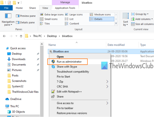

3] Run the executable file with Admin privilege
If running the Program Install and Uninstall Troubleshooter didn’t help, you can run the executable file with admin privilege and see if the software installs successfully without throwing the error in view. Try the next solution if the error reappears.

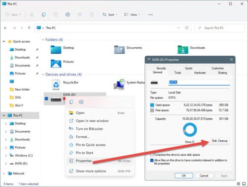

4] Run Disk Cleanup
Some files will be generated in a temp directory of the C: drive when you try to install a program on your Windows 11/10 computer. This error can occur if the available space of the system drive is insufficient or if you do not have the permission to create a temp directory there. In this case, check/analyze the available space of C: drive – and if the space is not enough, run Disk Cleanup on the drive or clean up Hard Disk via the Settings app on your device.

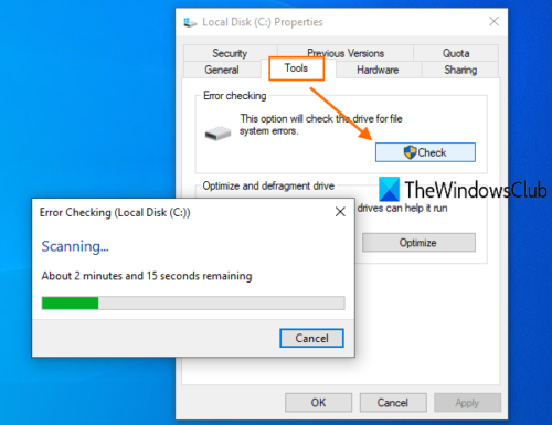

5] Run CHKDSK
This solution requires you to run CHKDSK to repair bad or corrupted sectors, which can cause inconsistencies in drive integrity and consequently trigger the error in view.
To run CHKDSK, do the following:
- In the Run dialog box, type cmd and then press CTRL + SHIFT + ENTER to open Command Prompt in admin/elevated mode.
- In the command prompt window, type the command below and hit Enter.
chkdsk /x /f /r
You will receive the following message:
Chkdsk cannot run because the volume is in use by another process. Would you like to schedule this volume to be checked the next time the system restarts? (Y/N).
- Tap Y key on the keyboard and then reboot your computer to let CHKDSK to check and fix the errors on the computer hard drive.
After CHKDSK completes, check to see if the issue is resolved. Otherwise, try the next solution.

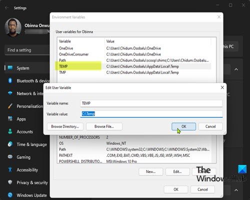

7] Manually create new Temp folder
This solution requires you to manually create new Temporary files folder and name it Temp on the system drive and change the variables.
Do the following:
- Open System Properties.
- Click on Advanced System Settings.
- Navigate to the Advanced tab.
- Click on the Environment Variables button at the bottom.
- Double-click on TEMP from the box at the top.
- Now, replace the value below in the field:
%USERPROFILE%\AppData\Local\Temp
with
C:\Temp
- Click OK > OK.
- Click Apply > OK to exit System Properties.
If the issue is still unresolved, you van try the next solution.

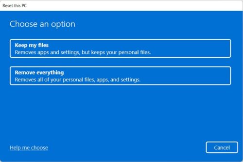

10] Reset Windows 11/10
At this point, if nothing has worked for you and the issue persists, you can reset Windows to resolve it. When performing the reset operation on your device, choose the option to keep your personal files.
