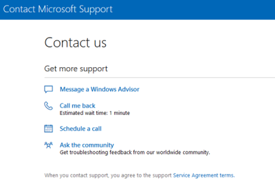

4] Activate via Microsoft Chat Support
A viable solution to the issue at hand is to activate Windows via phone by contacting Microsoft Support.
