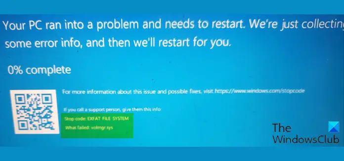

According to Microsoft documentation, the EXFAT_FILE_SYSTEM (volmgr.sys) bug check has a value of 0x0000012C, which indicates that a problem occurred in the Extended File Allocation Table (exFAT) file system. This post provides solutions PC users that have encountered this Blue Screen of Death error can try to successfully resolve this issue.

EXFAT FILE SYSTEM (volmgr.sys) Blue Screen error
If you’re faced with this EXFAT FILE SYSTEM (volmgr.sys) Blue Screen error on your Windows PC, you can try our recommended solutions below in no particular order and see if that helps to resolve the issue.

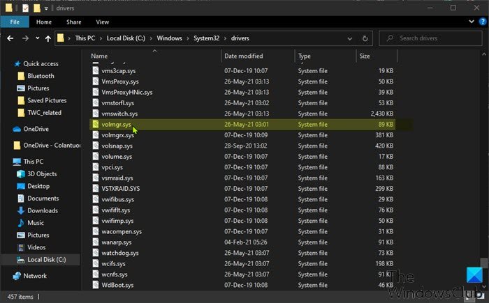

6] Replace volmgr.sys file
Do the following:
- Log into another working and recently updated Windows 10/11 PC.
- Plug in a USB flash drive.
- Press Windows key + E to open File Explorer.
- Navigate to the folder path below:
C:\Windows\System32\drivers
- At the location, copy the volmgr.sys file to the USB flash drive.
- Next, plug the flash drive into the problematic PC.
- Navigate to the same folder as above.
- Copy and paste the volmgr.sys file into that location to replace the faulty file.
- Exit File Explorer.
If the issue persists, try the next solution.
