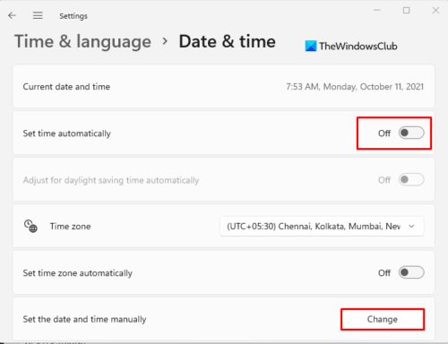

3] Manually adjust Date & time settings on PC
This is a workaround as well that worked for some affected users, which requires you to manually change the date to a previous date and then take a screenshot, once the capture is successful, change the date back to the current setting on your Windows 11/10 system, then relaunch the Snipping Tool app and take screenshots as usual.

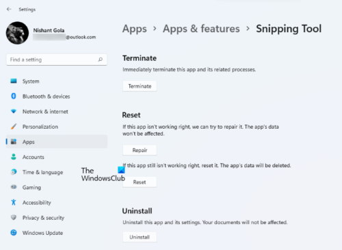

4] Repair/Reset/Uninstall Snipping Tool
This solution requires you to first repair the Snipping Tool app, and if that doesn’t resolve the issue at hand, you can proceed to reset the app. If neither of the actions worked for you, you can uninstall and reinstall Snipping Tool app. You can use 10AppsManager to uninstall, reinstall Windows Store apps and can also re-register or reinstall Windows Store Apps via PowerShell in Windows 11/10.
