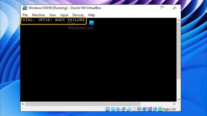

You may get the VirtualBox error FATAL: INT18: BOOT FAILURE when you attempt to start a Windows guest machine on your Windows 11 or Windows 10 host computer. This post offers the most applicable solutions you can try to successfully fix the error on your system.
You may encounter this issue due to one or more of the following reasons.
- it’s an indication the VM file is corrupt.
- Part of the boot sector is inactive.
- The operating system (OS) is unable to boot due to the partition holding the Boot Configuration Data (BCD) Store being inactive.
- The OS is unable to boot due to BCD Corruption.
- The OS is unable to boot due to the boot sector not being found.
Affected users reported the guest operating system running on the VM failed to start after converting the physical disk of a Windows 11/10 UEFI computer to a Virtual Hard disk (VHD or VHDX) and attaching the VHD/VHDX file to a new VirtualBox machine. The error sometimes may throw the error code 0x0000225.
Read: VirtualBox failed to register and open Hard Disk image file
VirtualBox FATAL: INT18: BOOT FAILURE Error
If you have encountered the FATAL: INT18: BOOT FAILURE error when you start a Windows Guest OS in VirtualBox on your host Windows 11/10 machine, you can apply our recommended fixes below to quickly and easily resolve the issue on your system.

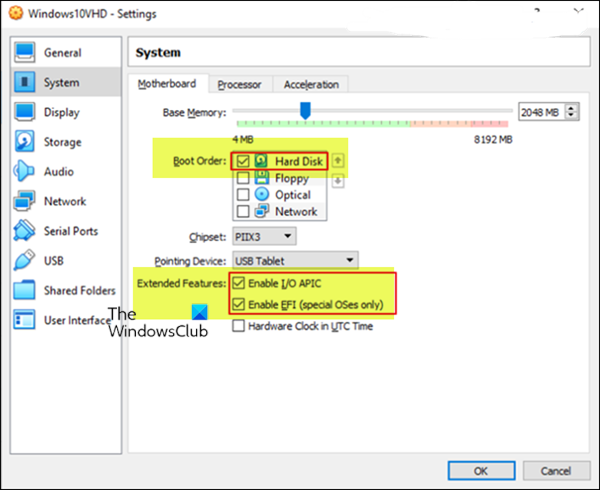

2] Enable I/O APIC & EFI in VirtualBox
You will encounter this error usually when you are attaching or opening a VHD/VHDX/VMDK file that contains a UEFI operating system. In this case, to resolve the issue, you need to simply enable EFI on the VirtualBox machine’s settings. To perform this task, do the following:
- Press the X button to close the VM machine window and Power Off the machine.
- Next, open the VM Settings.
- Go to System > Motherboard.
- In the Boot Order section, make sure that the Hard Disk is selected and is the first boot device.
- In the Extended Features section, select both the Enable I/O APIC and Enable EFI (special OSes only) options.
- Click OK.
