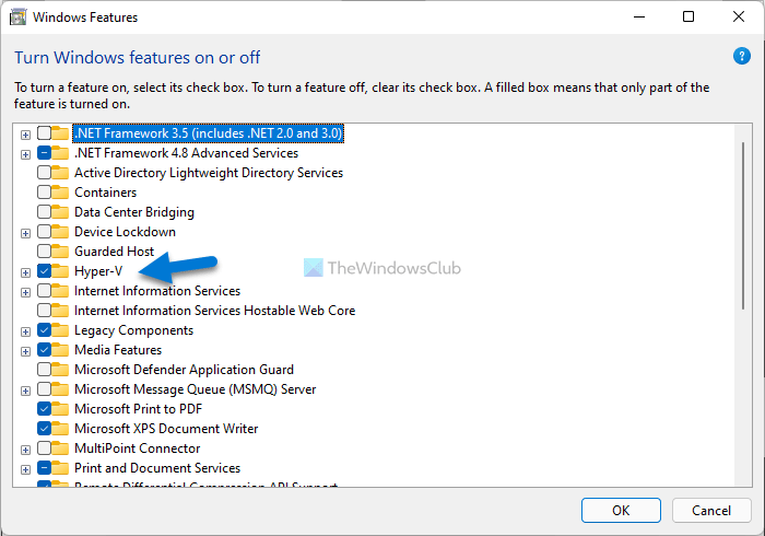

1] Enable Hyper-V
It is the first thing you need to do to fix the issue stated above. Hyper-V is a must-have feature or functionality required for using Windows Subsystem for Linux on your Windows computer. Therefore, the following steps help you to enable Hyper-V on your PC:
- Click on the Taskbar search box.
- Type turn windows features on or off.
- Click on the individual search result.
- Find out Hyper-V.
- Tick the corresponding checkbox.
- Click the OK button.
- Let it finish the installation.
- Restart your computer.
After that, you will be able to use the Windows Subsystem for Linux without any problem.

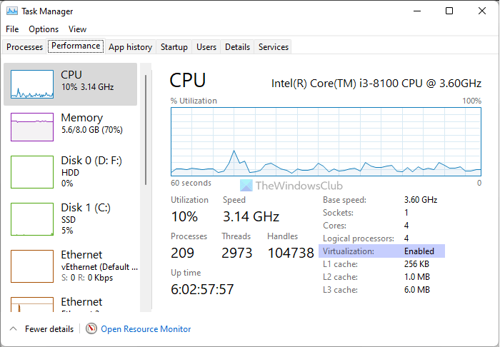

2] Enable Hardware Virtualization
In order to use the Hyper-V powered Windows Subsystem for Linux on your PC, you need to turn on the hardware virtualization. If you mistakenly disabled it after installing WSL, you need to check and enable this feature from the BIOS. Before that, you can open the Task Manager on your computer and switch to the Performance tab. Here you can find a label called Virtualization.
Make sure that the status is showing as Enabled. If not, you need to follow this guide to enable hardware virtualization in Windows PC.

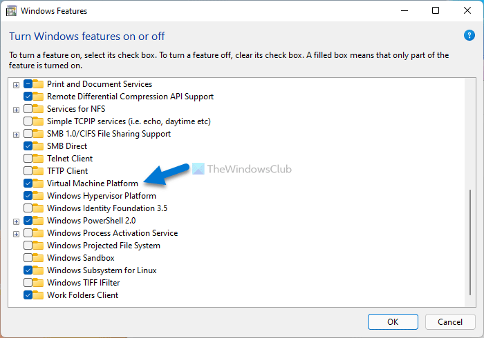

4] Turn on Virtual Machine Platform
The Virtual Machine Platform is another mandatory feature that you need to enable to resolve Error 0x80370102 when starting the Windows Subsystem for Linux. To enable the Virtual Machine Platform, do the following:
- Search for turn windows features on or off in the Taskbar search box.
- Click on the search result.
- Find out Virtual Machine Platform option.
- Let the installation be completed.
- Reboot your computer.
After that, try running the WSL on your PC.
