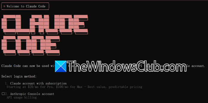

Claude Code is a useful way to work with a codebase directly from the terminal, but it can get messy when running inside WSL on Windows. If Claude refuses to start, crashes, shows “command not found,” or gets stuck during login or installation, the problem is usually related to the WSL version, PATH, Node.js, or how Claude Code was installed. In this post, we will see what you can do if Claude Code is not working in WSL on Windows.
Claude Code not working in WSL
Claude Code runs as a Linux application when you launch it from WSL, so it needs to see the Linux environment correctly. Problems often appear when WSL picks up Windows versions of Node.js or npm, when Claude Code was installed using a conflicting npm setup, or when the distribution is still running WSL 1. Authentication can also fail because the Windows browser and the Claude process inside WSL do not always communicate correctly through the localhost callback.

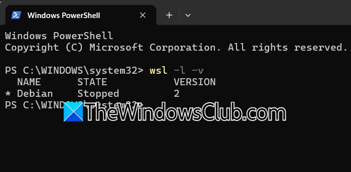

1] Make sure your WSL distribution is running on WSL 2
If Claude Code gives you an Exec format error, or it simply refuses to execute even though the installation appears correct, check which version of WSL your Linux distribution is using. Claude Code currently supports WSL 1 and WSL 2, but Anthropic documents a native-binary problem affecting WSL 1. Moving the distribution to WSL 2 is the cleaner fix.
First, open PowerShell and run the following command.
wsl -l -v
Look at the VERSION column. If your Ubuntu or other distribution shows 1, convert it to WSL 2 using the command given below.
wsl --set-version Ubuntu 2
Replace Ubuntu with the exact distribution name shown by wsl -l -v.

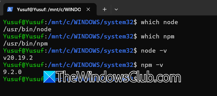

2] Check whether WSL is using Windows Node.js
This is one of the more important things to check if you installed Claude Code with npm. WSL can inherit Windows paths, so commands such as node and npm may actually point to executables installed under C:\Program Files\… rather than Linux binaries.
Run these commands inside WSL.
which node which npm node -v npm -v
If which node or which npm returns a path beginning with /mnt/c/, you are probably using the Windows installation.
Claude Code’s documentation specifically calls out this WSL problem. The Linux versions should normally resolve to paths under /usr/ or your Linux user’s home directory.
If you use NVM, load it in WSL using the following script.
export NVM_DIR=”$HOME/.nvm” [ -s “$NVM_DIR/nvm.sh” ] && \. “$NVM_DIR/nvm.sh”
Then install a current LTS version of Node.
nvm install --lts nvm use --lts
Check again using the command given below.
