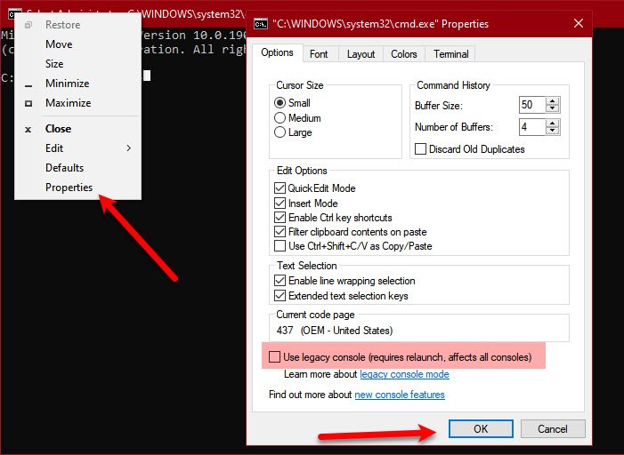

3] Error: 0x80040306 on Installation
If you are seeing Error: 0x80040306 on Installation. To fix this you need to disable Legacy Console. To do that, follow the given steps.
- Open Command Prompt as an administrator from the Start Menu.
- Right-click on the cmd logo and select Properties.
- Now, uncheck “Use legacy console” and click Ok.
Finally, check if it fixes the issue.

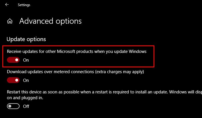

4] Cannot access WSL files from Windows
If you are unable to access Windows Subsystem for Linux by \\wsl$ on Windows, this could be mean that the 9P protocol file server fails to start.
The easiest fix is to update your computer and enable “updates for Microsoft products on Windows Update”. To do that, you can follow the given steps.
- Launch Settings by Win + I.
- Click Update & Security > Advanced options.
- Use the toggle to disable “Receive updates for other Microsoft products when you update Windows“.
This will fix the issue for you.
