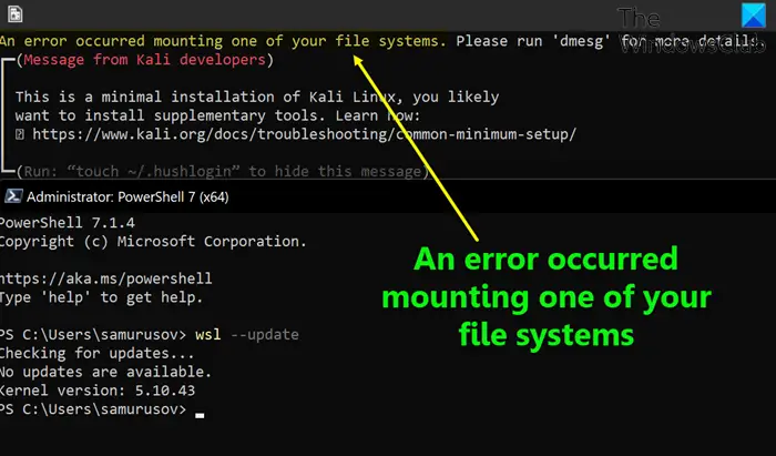

While opening the Windows Subsystem for Linux on Windows 11/10, if you get an error message saying An error occurred mounting one of your file systems, these solutions will troubleshoot the issue. It happens when your system fails to mount the drive. However, you can get rid of this problem with the help of these tips. The entire error message says something like this:
An error occurred mounting one of your file systems. Please run ‘dmesg’ for more details.
For your information, dmesg is used to examine or control the kernel ring buffer. In this article, we will see what you need to do to resolve this issue.

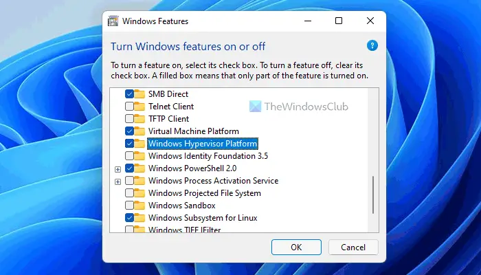

1] Reinstall Windows Hypervisor Platform
To use Windows Subsystem for Linux, you must enable a few things on your Windows 11 or Windows 10 computer. For example, it is required to enable Virtual Machine Platform, Windows Hypervisor Platform, etc. If you have disabled those two elements, or even just one, you might encounter this issue on your PC. In most cases, people disable the Windows Hypervisor Platform. Therefore, it is recommended to verify the setting before heading toward other options.
To reinstall the Windows Hypervisor Platform, follow these steps:
- Search for turn Windows features on or off.
- Click on the individual search result.
- Remove the tick from the Windows Hypervisor Platform checkbox.
- Click the OK button.
- Restart your computer.
- Open the same Windows Features panel.
- Tick the Windows Hypervisor Platform checkbox.
Once done, you will be able to use WSL without any error. However, if it doesn’t help, you can follow the other two solutions mentioned below.

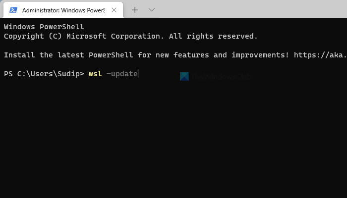

2] Update Windows Subsystem for Linux
Updating the Linux Kernel or WSL often helps fix this issue on Windows 11/10 PC. If you haven’t tried this solution earlier, it is recommended to update the Linux Kernel on your PC. The process is pretty straightforward, and you can do that using the following steps:
- Press Win+X to open the WinX menu.
- Select Windows Terminal (admin) option.
- Click on the Yes button.
- Enter this command:
wsl –update - Allow the process to complete.
Once done, you can close the Windows Terminal window and start the Windows Subsystem for Linux.

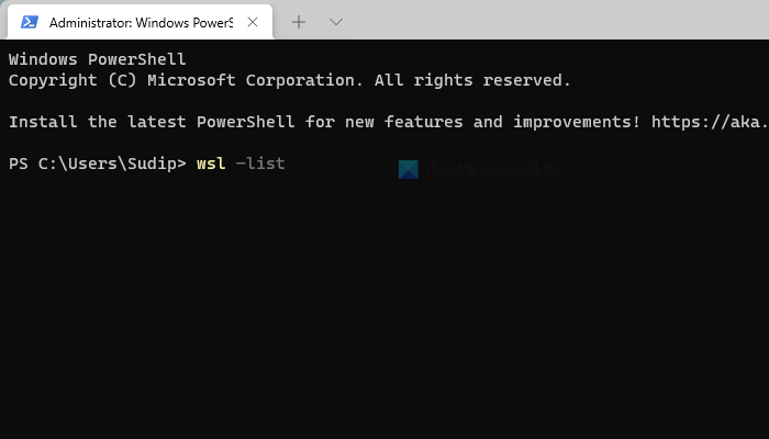

3] Set default distribution
If you have installed Docker on your WSL, you might encounter this problem while running it on your PC. In such situations, you need to verify and set the correct distribution as the default one. For that, do the following:
- Open Command Prompt with administrator privilege.
- Enter this command: wsl –list
- Enter this command to set the correct distribution as the default one: wsl -s name-of-distro
After that, close the Command Prompt window and check if you can run WSL or not.
4] Check the distribution
You need to make sure that your distribution is set to default. Otherwise, you will see the error message in question. To do that, again launch Command Prompt as an administrator and run the following command.
wsl –list
If it is not default, run the following command.
wsl -s distroName
Note: Replace “distroName” with the name of the distribution.
Now, run WSL and see if it works.

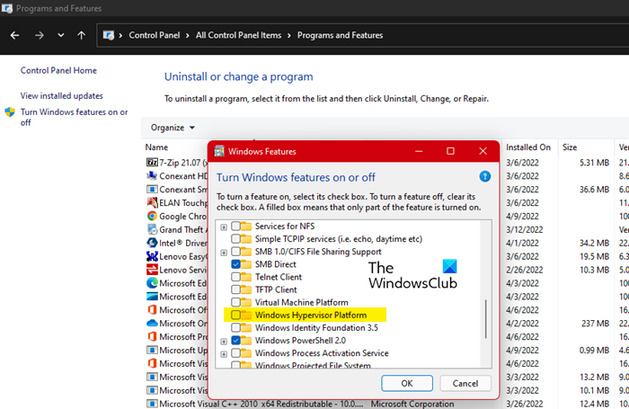

5] Disable Windows Hypervisor Platform
If that doesn’t work, we need to disable Windows Hypervisor Platform. This has worked for a lot of users experiencing issues with WSL, so we are assuming that it will work for you as well. Follow the given steps to do the same.
- Open Control Panel.
- Make sure your View by is set to Large icons.
- Click on Programs and Features.
- Go to Turn Windows features on or off.
- Untick Windows Hypervisor Platform.
- Click Ok.
Hopefully, it will do the job for you.
