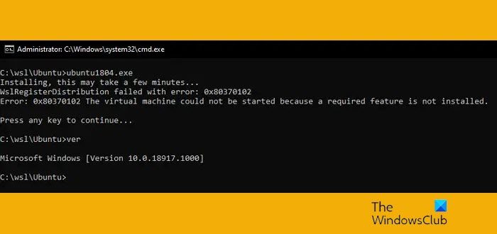

When installing WSL, if you receive an error saying— WslRegisterDistribution failed with error: 0x80370102—then this post will help you resolve it. The Error occurs for a couple of reasons. Nested Virtualization, a limit on the CPUID, Virtualization support, and more.
WslRegisterDistribution failed with error: 0x80370102.
Error: 0x80370102 The Virtual machine could not be started because a required feature is not installed
WslRegisterDistribution failed with error 0x80370102
