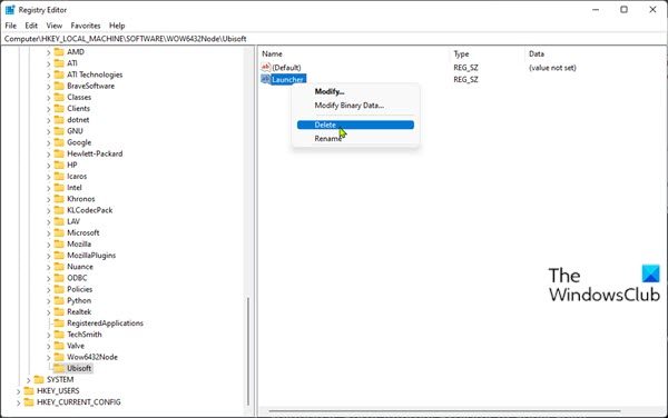

7] Modify Registry – Delete Ubisoft Launcher key (if applicable)
You may encounter this issue when you try to launch applications like Uplay, Internet Explorer, some older incompatible games designed for earlier versions of Windows. And as investigation reveals, the issue in hand seems to be a widespread issue on Windows 11/10, especially among users that have both Steam and Uplay installed at the same time. In this case, to resolve the issue, you need to delete the registry entry associated with the Uplay launcher – this supposedly eliminates the conflict, allowing both applications to function properly under the same machine.
Do the following:
Computer\HKEY_LOCAL_MACHINE\SOFTWARE\WOW6432Node\Ubisoft
- At the location, on the right pane, right-click the Launcher entry and select Delete.
If you get an error while deleting the registry key on your Windows 11/10 system, you can take ownership of the registry key and try the delete operation again.
- Once deleted, exit Registry Editor.
- Restart PC.

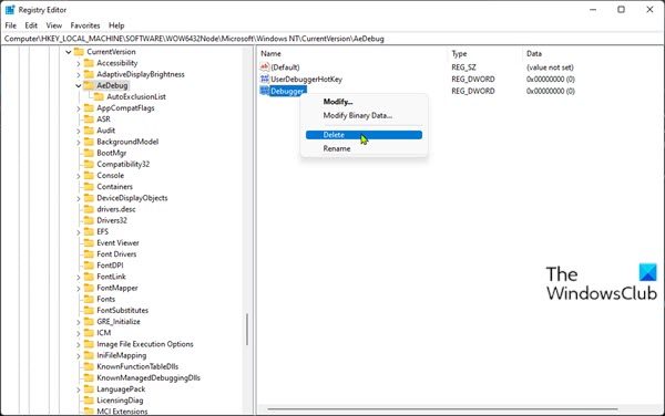

- Depending on your system architecture, navigate or jump to the registry key path below:
For 32-bit users
HKEY_LOCAL_MACHINE\SOFTWARE\Microsoft\Windows NT\CurrentVersion\AeDebug
For 64-bit users
HKEY_LOCAL_MACHINE\SOFTWARE\Wow6432Node\Microsoft\Windows NT\CurrentVersion\AeDebug
- At the location, on the right pane, right-click on the Debugger key, and click Delete.
- Next, jump to the registry key path below:

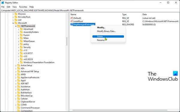

For 32-bit users
HKEY_LOCAL_MACHINE\SOFTWARE\Microsoft\.NETFramework
For 64-bit users
HKEY_LOCAL_MACHINE\SOFTWARE\Wow6432Node\Microsoft\.NETFramework
- At the location, on the right pane, right-click on the DbgManagedDebugger key, and click Delete.
- Exit Registry Editor.
