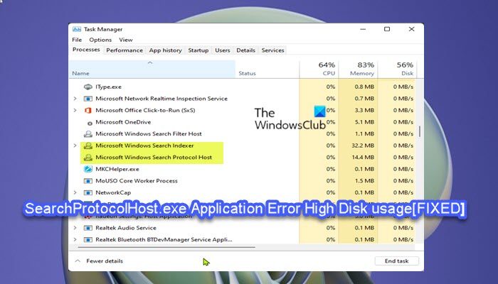

If you’re experiencing SearchProtocolHost.exe High Disk usage on your Windows 11 or Windows 10 computer, then this post is intended to help affected PC users with the most adequate solutions to resolve this issue on your system.
SearchProtocolHost.exe is part of the Windows Indexing Service, a process that indexes files on the local drive making them easier to search. SearchIndexer.exe provides content indexing, property caching, and search results for files, e-mail, and other content. SearchIndexer and SearchProtocolHost processes communicate with each other frequently and even if you terminate SearchProtocolHost.exe, SearchIndexer.exe will restart it again.

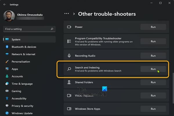

To run Search and Indexing Troubleshooter on your Windows 11 device, do the following:
- Press Windows key + I to open Settings app.
- Under the Other section, find Search and Indexing.
- Click Run button.

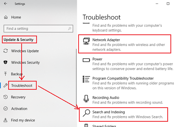

To run the Search and Indexing Troubleshooter on your Windows 10 PC, do the following:
- Go to Update and Security.
- Scroll down and click on Search and Indexing.

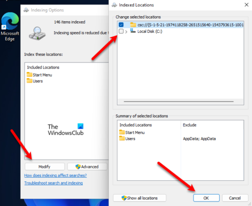

3] Change Indexing Options
You can change Indexing Options in Windows 11/10 assuming you don’t want a drive or a folder to be included in Search Indexing. You can uncheck the larger locations (eg. C: if it is your system drive, etc.).
