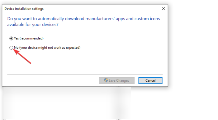

3] Pause Driver updates, reboot and unpause Driver updates
Pausing and unpausing updates can resolve the Semiconductor Corp Extension error. There are different ways to pause updates but for this post, we can use the Control Panel. Here is how you do it:
- Press the Windows key + R and type Control. This will open your Control Panel.
- Go to System > Advanced System Settings
- A new small System Properties window will appear. Go to the Hardware tab on the top bars and select Device Installation Settings.
- Click the box next to No (your device might not work as expected)
- After the first steps are complete, you can now go ahead and restart your computer. Wait about 3 minutes before rebooting and moving on to the next step. To unpause the updates, you can follow the pausing steps above and select Yes in the final step. Go back and try to install the Realtek Semiconductor Corp Extension.

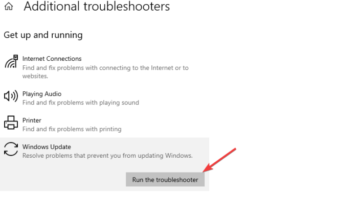

4] Run Windows Update Troubleshooter
The Windows update troubleshooter can detect and fix issues that trigger the Realtek Semiconductor Corp Extension Install error. To run the Windows Update troubleshooter, follow the steps below;
- Search Troubleshoot in the Windows search box and click Open to launch the Troubleshoot settings.
- Next, go to the Additional troubleshooters option.
- The last in the list is Windows Update; click on it and choose Run the troubleshooter.
- If the troubleshooter found an issue, it will automatically fix the error or recommend what you need to do. After everything is fixed, restart your PC.
- Go ahead and try to install your driver again and see if you will get the error.
